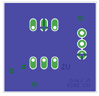

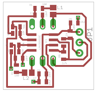

The layout took me about an hour and a half!  I don’t think it came out too badly.  There was a great deal of moving components and tracks about.  It was completely routed by hand – I don’t agree with using an auto-router.  The results are always poor (in my opinion).
Top Layer of Pressure Sensor Breakout
Bottom Layer of Pressure Sensor Breakout
The combined layers with dimensions
I managed to get it all into a tight space – less than 22 mm is fair I feel.  The electronics is all on the top side and the pressure sensor is on the bottom side.  When in use the top side will be facing downwards but that is no hardship. I used a design rule checking file from a board manufacturing house to check that the design is viable and they can make it – It passed with no errors!  I must be getting better at this…

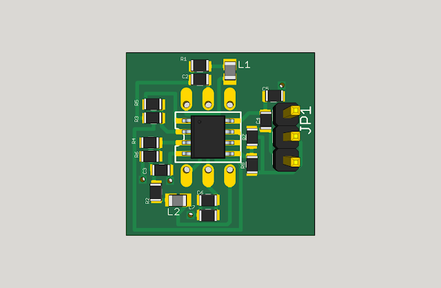

Just for fun and because I have found it lets me know if mechanically the design won’t work – here is the PCB rendered in 3D.
The rendered PCB top layer
The rendered PCB viewed isometrically
